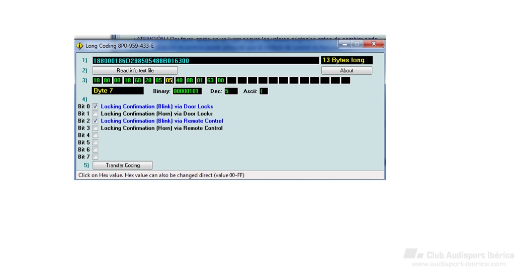

Chassis Type: 1K0 Scan: 01 03 08 09 15 16 17 19 25 37 42 44 46 47 52 56 62 72 77 VIN: WAUZZZ8P98A103942 Mileage: 94020km/58421miles 01-Engine -- Status: OK 0000 03-ABS Brakes -- Status: OK 0000 04-Steering Angle -- Status: OK 0000 08-Auto HVAC -- Status: OK 0000 09-Cent. Elect. -- Status: OK 0000 15-Airbags -- Status: OK 0000 16-Steering wheel -- Status: OK 0000 17-Instruments -- Status: OK 0000 19-CAN Gateway -- Status: OK 0000 25-Immobilizer -- Status: OK 0000 37-Navigation -- Status: Malfunction 0010 42-Door Elect, Driver -- Status: OK 0000 44-Steering Assist -- Status: OK 0000 46-Central Conv. -- Status: Malfunction 0010 47-Sound System -- Status: OK 0000 52-Door Elect, Pass. -- Status: OK 0000 56-Radio -- Status: Malfunction 0010 62-Door, Rear Left -- Status: OK 0000 72-Door, Rear Right -- Status: OK 0000 77-Telephone -- Status: OK 0000 ------------------------------------------------------------------------------- Address 01: Engine Labels: 03G-906-016-BKD.lbl Part No SW: 03G 906 021 LG HW: 03G 906 021 AN Component: R4 2,0L EDC G200SG 9828 Revision: --H07--- Serial number: AUX7Z0GNFN605G Coding: 0000072 Shop #: WSC 00815 572 57390 VCID: 6FE9D78F070D No fault code found. Readiness: 0 0 0 0 0 ------------------------------------------------------------------------------- Address 03: ABS Brakes Labels: 1K0-907-379-MK60-F.lbl Part No SW: 1K0 907 379 AC HW: 1K0 907 379 AC Component: ESP FRONT MK60 0101 Revision: 00H11001 Coding: 0023170 Shop #: WSC 06314 000 00000 VCID: 73E1DBFF6B25 No fault code found. ------------------------------------------------------------------------------- Address 08: Auto HVAC Labels: 8P0-820-043.lbl Part No SW: 8P0 820 043 AG HW: 8P0 820 043 AG Component: KlimavollautomatH19 0420 Revision: 212526 Serial number: 8P0820043AG Shop #: WSC 00000 000 00000 VCID: 71EDD1F71139 No fault code found. ------------------------------------------------------------------------------- Address 09: Cent. Elect. Labels: 8P0-907-279-30-H.lbl Part No SW: 8P0 907 279 K HW: 8P0 907 279 K Component: Bordnetz-SG H54 2501 Revision: 00H54000 Serial number: 00000007876047 Coding: B1884F29902D100018321E4B1E0000000008FF1F321102AE000000000000 Shop #: WSC 06314 000 08192 VCID: 458555277531 Part No: 8P1 955 119 E Component: Wischer AU350 H01 0130 Coding: 00061712 Shop #: WSC 06314 No fault code found. ------------------------------------------------------------------------------- Address 15: Airbags Labels: 8P0-959-655-94.lbl Part No SW: 8P0 959 655 L HW: 8P0 959 655 L Component: Airbag 9.41 H01 4210 Revision: 91H01421 Serial number: 003CP001N20N Coding: 0070612 Shop #: WSC 06314 000 00000 VCID: 4B91631F5355 No fault code found. ------------------------------------------------------------------------------- Address 16: Steering wheel Labels: 8P0-953-549-F.lbl Part No SW: 8P0 953 549 F HW: 8P0 953 549 F Component: J0527 H36 0070 Coding: 0004042 Shop #: WSC 06314 000 00000 VCID: 418D41376119 Part No: XXXXXXXXXXX Component: E0221 H02 0030 No fault code found. ------------------------------------------------------------------------------- Address 17: Instruments Labels: 8P0-920-xxx-17-MY8.clb Part No SW: 8P0 920 931 E HW: 8P0 920 931 E Component: KOMBIINSTR. VDO H20 0640 Revision: D0H20001 Serial number: 224NG001116220 Coding: 0004129 Shop #: WSC 00815 572 173408 VCID: 356525E725D1 No fault code found. ------------------------------------------------------------------------------- Address 19: CAN Gateway Labels: 1K0-907-530.lbl Part No SW: 1K0 907 530 L HW: 1K0 907 951 Component: J533__Gateway H15 0180 Revision: H15 Serial number: 1400K07B0206EF Coding: E9807F065006020102 Shop #: WSC 06314 000 00000 VCID: 306B14F3DAB3 No fault code found. ------------------------------------------------------------------------------- Address 25: Immobilizer Labels: 1K0-920-xxx-25.clb Part No SW: 8P0 920 931 E HW: 8P0 920 931 E Component: KOMBIINSTR. VDO H20 0640 Revision: D0H20001 Serial number: AUX7Z0GNFN605G Shop #: WSC 00000 000 00000 VCID: 356525E725D1 No fault code found. ------------------------------------------------------------------------------- Address 37: Navigation Labels: 8E0-035-192-RNSE.lbl Part No SW: 8E0 035 192 T HW: 8E0 035 192 T Component: RNS-E HIGH EU H74 X--- Revision: 05S Serial number: AUZBZ7H1100134 Coding: 0209715 Shop #: WSC 02236 264 21716 VCID: 356525E725D1 1 Fault Found: 02005 - Coding Pin 004 - No Signal/Communication Freeze Frame: Fault Status: 01100100 Fault Priority: 5 Fault Frequency: 1 Reset counter: 52 Mileage: 93055 km Time Indication: 0 Date: 2012.04.07 Time: 21:04:41 ------------------------------------------------------------------------------- Address 42: Door Elect, Driver Labels: 8P0-959-801-MIN3.lbl Part No SW: 8P0 959 801 K HW: 8P0 959 801 K Component: Tuer-SG H03 0050 Coding: 0000144 Shop #: WSC 06314 000 00000 VCID: 43814B3F7B05 No fault code found. ------------------------------------------------------------------------------- Address 44: Steering Assist Labels: 1Kx-909-14x-44.clb Part No: 1K1 909 144 M Component: EPS_ZFLS Kl.078 H08 1901 Shop #: WSC 02069 000 90108 VCID: 356525E725D1 No fault code found. ------------------------------------------------------------------------------- Address 46: Central Conv. Labels: 8P0-959-433.lbl Part No: 8P0 959 433 L Component: KSG H11 0080 Coding: 1880202002403F000505004F0107 Shop #: WSC 06314 000 00000 VCID: 458555277531 Component: Sounder n.mounted Component: NGS n.mounted Component: IRUE n.mounted 2 Faults Found: 01333 - Door Control Module; Rear Left (J388) 004 - No Signal/Communication 01334 - Door Control Module; Rear Right (J389) 004 - No Signal/Communication ------------------------------------------------------------------------------- Address 47: Sound System Labels: 8Px-035-382.lbl Part No SW: 8P4 035 382 D HW: 8P4 035 382 D Component: AB2 SUBWOOFERBOXH06 0180 Revision: 00005 Serial number: 30674752984836 Shop #: WSC 00000 000 00000 VCID: 356525E725D1 No fault code found. ------------------------------------------------------------------------------- Address 52: Door Elect, Pass. Labels: 1K0-959-702-MIN3.lbl Part No SW: 8P0 959 802 K HW: 8P0 959 802 K Component: Tuer-SG H03 0050 Coding: 0000144 Shop #: WSC 06314 000 00000 VCID: 448348237E0B No fault code found. ------------------------------------------------------------------------------- Address 56: Radio Labels: 8E0-035-192-RNSE.lbl Part No SW: 8E0 035 192 T HW: 8E0 035 192 T Component: RNS-E HIGH EU H74 X--- Revision: 05S Serial number: AUZBZ7H1100134 Coding: 0209715 Shop #: WSC 02236 264 21716 VCID: 356525E725D1 1 Fault Found: 02005 - Coding Pin 004 - No Signal/Communication Freeze Frame: Fault Status: 01100100 Fault Priority: 5 Fault Frequency: 1 Reset counter: 52 Mileage: 93055 km Time Indication: 0 Date: 2012.04.07 Time: 21:04:41 ------------------------------------------------------------------------------- Address 62: Door, Rear Left Labels: 8P4-959-801.lbl Part No SW: 8P4 959 801 E HW: 8P4 959 801 E Component: Tuer-SG H04 0040 Coding: 0000144 Shop #: WSC 06314 000 1012544 VCID: 418D41376119 No fault code found. ------------------------------------------------------------------------------- Address 72: Door, Rear Right Labels: 8P4-959-802.lbl Part No SW: 8P4 959 802 E HW: 8P4 959 802 E Component: Tuer-SG H04 0040 Coding: 0000144 Shop #: WSC 06314 000 1012544 VCID: 428F4E3B641F No fault code found. ------------------------------------------------------------------------------- Address 77: Telephone Labels: 8P0-862-335.lbl Part No SW: 8P0 862 335 H HW: 8P0 862 335 H Component: FSE_255x BT H26 0290 Revision: 00000000 Serial number: 00000005065356 Coding: 0011405 Shop #: WSC 01236 785 00200 VCID: 3B7133DF03F5 No fault code found. _____________________________________________________________________________________________________________________________________________________________________________________________________________________________________________________________________________________________________________________________________________________________________________________________________________________________________________________________________________________________ Esto son los problemas que me da, no se como he conseguido que no me bajen/suban las ventanas desde el mando y cuando cierre o abra desde el mando los intermitentes no se encienden y me dan los dos errores de comunicacion de las dos puertas trasaeras y del navegador, no entiendo porque. Me he dejado horas tocando y tocando pero no lo vuelvo a dejar como estaba. Alguien me podria dar las configuraciones de sus centralitas? Mi sportback es del 2008 con chasis del 2010 con centralita de 30byts, es el modelo ambition con volante multifuncion, navegador, telefono etc bueno en el txt del vag sale todo a ver si alguien me puede ayudar porque estoy desesperado. Un saludo y gracias de ante mano.
Hombre ya somos dos que nos pasa lo mismo!!! al menos es un consuelo jajaja, a ver... Me pasa lo mismo que a ti pero a mi me da un error comunicacion con las puestas traseras ya que el mio es un sportback del 2008 con centralita de 30bits, no se que narices ha pasado pero me ha dejado de subir y bajar la ventanas con cierre confort desde el mando y los intermitentes de señalización cuando abro y cierro el coche, lo cierto es que no se como ayudarte, lo unico que he pensado es que conseguir la configuracion de uno como el mio (A3 sportback 2008 con MY10 sin alarma,sin techo) y ponerla a ver si vuelve al pricipio porque en su dia no me guarde ninguna configuracion. Bueno a ver si movemos el tema porque es una put*dita lo de las ventanas.
