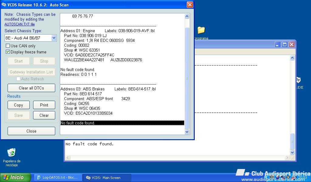

  4. despues de cambiarle el sensor G62 le he vuelto apasr el vag com y me sale esto y sigue sin arrancar ayudaaa. 906-019-AVF.lbl Part No: 038 906 019 LJ Component: 1,9l R4 EDC 0600SG 5934 Coding: 00002 Shop #: WSC 63351 VCID: 6AD0DE2C7A25FF4C WAUZZZ8E44A227481 AUZ6Z0D0023876 No fault code found. Readiness: 0 0 1 1 1
  5. Aki os dejo lo que me ha salido en el vagcom esta tarde aver ke puede ser porke no entiendo ni papa Tuesday,23,August,2011,20:26:25:36838 VCDS Version: Release 10.6.2VCDS Version: Release 10.6.2 Data version: 20101123 Tuesday,23,August,2011,20:24:29:36838 Chassis Type: 8E - Audi A4 B6/B7 Scan: 01 02 03 08 09 0F 11 15 16 17 18 36 37 45 46 55 56 57 65 67 69 75 76 77 ------------------------------------------------------------------------------- Address 01: Engine Labels: 038-906-019-AVF.lbl Part No: 038 906 019 LJ Component: 1,9l R4 EDC 0600SG 5934 Coding: 00002 Shop #: WSC 63351 VCID: 6AD0DE2C7A25FF4C WAUZZZ8E44A227481 AUZ6Z0D0023876 1 Fault Found: 17664 - Engine Coolant Temp Sensor (G62): Open or Short to Plus P1256 -- 35-10 - - - Intermittent Readiness: 0 1 0 0 0 ------------------------------------------------------------------------------- Address 03: ABS Brakes Labels: 8E0-614-517.lbl Part No: 8E0 614 517 Component: ABS/ESP front 3429 Coding: 04255 Shop #: WSC 06435 VCID: E5CA2D10133B5034 No fault code found. Data version: 20101123
