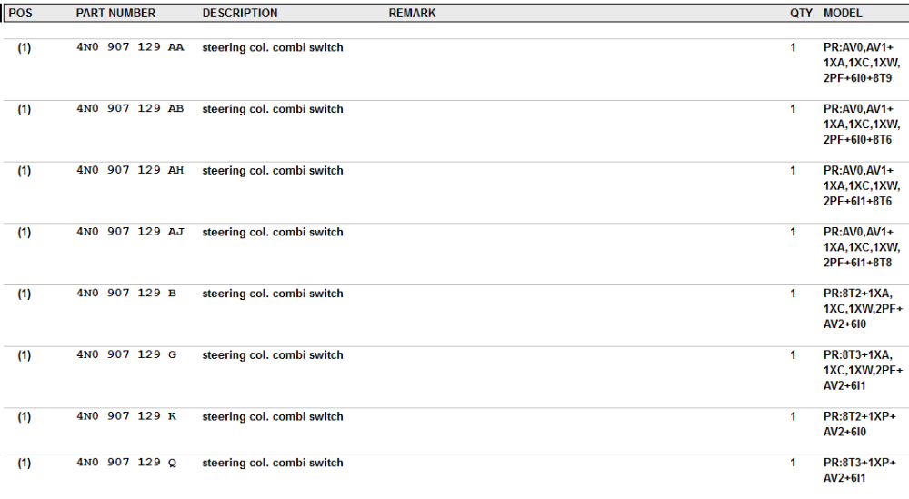

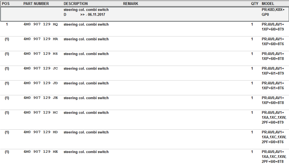

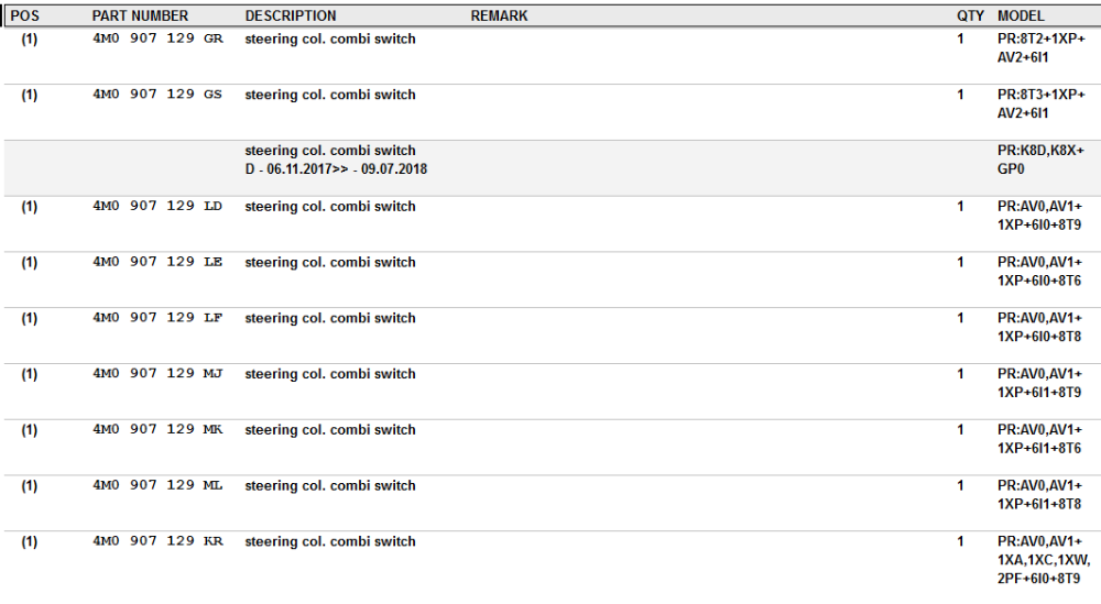

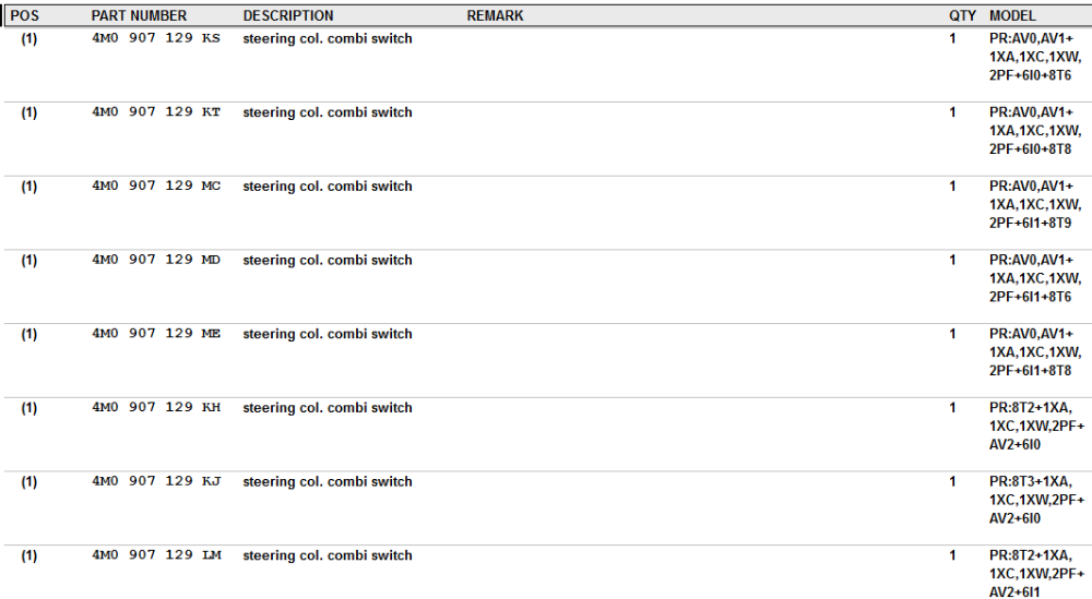

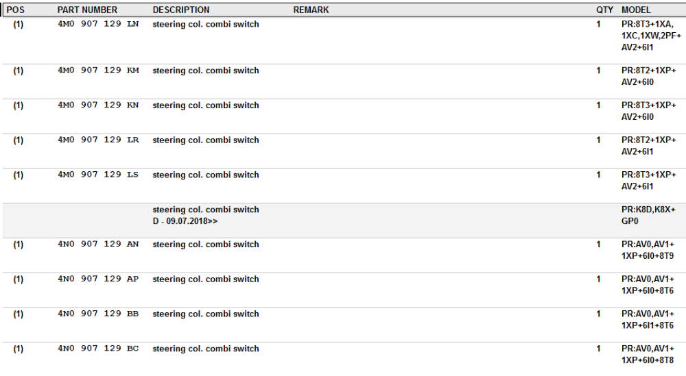

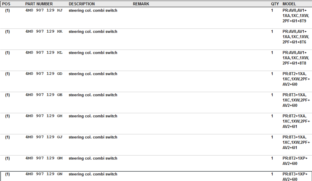

8T2 Electronic cruise control system (CCS) 8T3 Adaptative cruise control 8T6 Cruise control system and speed limiter 8T8 Adaptative cruise control (with "follow-to-stop") and speed limiter 8T9 Speed limiter without cruise control system and without adaptative cruise control K8B Notchback ("Para A4 Sedan") K8D avant K8X Allroad 1XA Multifunction steering wheel (??) 1XC Multifunction steering wheel (basic) 1XW Leather wrapped multifunction sports steering wheel (plus) 1XP Leather wrapped multifunction sports steering wheel (Volante calefactable) 2PF Leather wrapped multifunction sports steering wheel (volante plano por debajo) AV0 Driving on left AV1 Driving on right 6I1 Lane Keeping system 6I0 Without lane keeping system GP0 Vehicles without special upgrade measures (No se lo que es pero en principio son estos) GP1 Vehicles with special upgrade measures 4M0 907 129 HJ (o LA) o MC para volante sin calefactar 4M0907 129 JC (o LG) o MJ para volante calefactable Adjunto capturas de todas las referencias para el avant

El codigo 4M0 907 129 HH corresponde a las opciones AV0,AV1+1XA,1XC,1XW,2PF+6I1+8T8 8T8 Adaptative cruise control 1XA Multifunction steering wheel (??) 1XC Multifunction steering wheel (basic) 1XW Leather wrapped multifunction sports steering wheel (plus) 2PF Leather wrapped multifunction sports steering wheel (volante plano por debajo) AV0 Driving on left AV1 Driving on right 6I1 Lane Keeping system En principio el codigo de volante calefactable (1XP) no sale, asi que el fallo del volante calefactable deberia que estar en otro sitio, yo miraria en el modulo del mmi o del velocimetro
