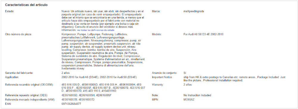

  16. Pues esto me contestaron cuando les pedi si tenian la omologacion para España... Good morning Paul. I received your email regarding your Audi A8. We do not have the paperwork that certifies our product in Spain but we have shipped to Spain before. The latest order is as recent as last month. Let me know if you have any other questions. I am happy to help.

  20. ¿Buenas tardes, para cambiar a este tipo de amortiguadores estándar, tienen que estar homologados en España?
