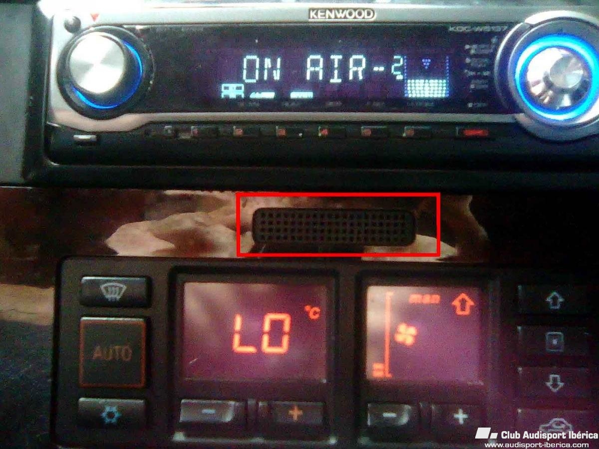

i found something interesting: (not for model audi a3)
1 - Kick down switch
Not installed on all vehicles
Disengages A/C compressorCan also be controlled by Transmission Control Module (TCM) or Engine Control Module (ECM)
2 - Connector station
3 - Footwell/defroster flap motor -V85-
With position sensor -G114-
4 - A/C control head -E87-
5 - Fresh air blower -V2-
6 - Control module for fresh air blower -J126-
7 - Interior temperature sensor fan -V42-
8 - Instrument panel interior temperature sensor -G56-
9 - Outside air temperature display -G106-
10 - Temperature regulator flap motor -V68-
With temperature regulator flap motor position sensor -G92-
11 - Central air flap motor -V70-
With central flap motor position sensor -G112-
12 - A/C refrigerant low pressure switch -F73-
13 - Evaporator housing and heater box
14 - Fresh air intake duct temperature sensor -G89-
15 - Fresh air/recirculating flap vacuum motor
16 - Fresh air/recirculating flap two-way valve
17 - Headliner interior temperature sensor -G86-
