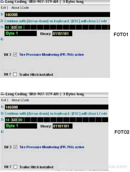

MMI basic (non-MMI - 2G) (symphony/concert radio): FOTO1
[56 - Radio]
[Coding - 07] -> Long Coding Helper -> Byte 8
Bit 6 - TPMS Settings active
Activar conexíon MMI ABS-ESP: FOTO2
[03 - ABS Brakes]
[security Access - 16] (probably with login code: 61378)
[Coding - 07] -> Long Coding Helper -> Byte 1
Bit 3 - Tire Pressure Monitoring (PR-7K6) active (1 = active)
Habilitar TPMS en panel instrumentos:
[17 - Instruments]
[Coding - 07] -> Long Coding Helper -> Byte 4
Bit 0 - Tire Pressure Monitoring (TPMS) installed (1 = active)
